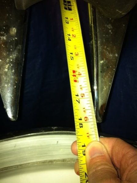

Back from boat with more measurements. I have made a small drawing:
Hope, it will help.
Greetings - Heiner

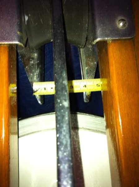

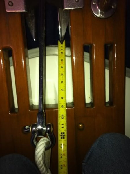

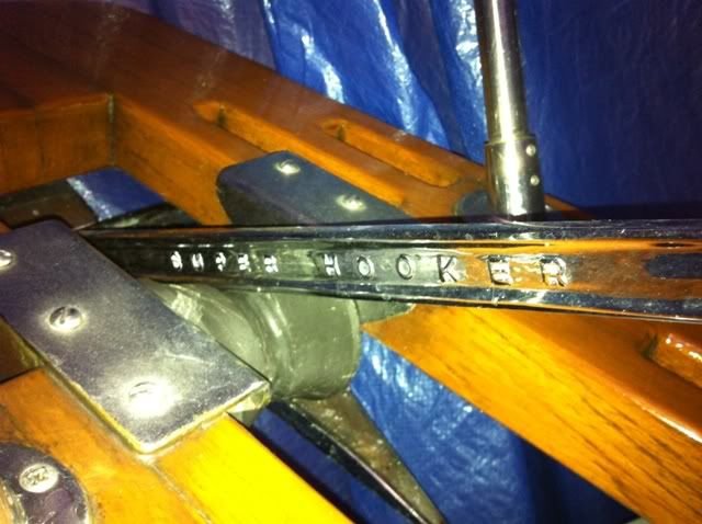

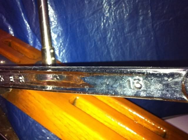

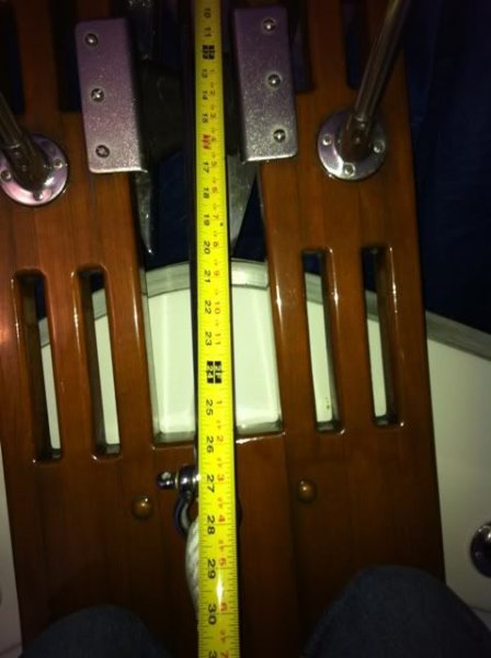

Posts: 1922
Heiner - measured my anchor tonight, and think it (mostly) fits your measurements.
Danforth Super Hooker, 13 pound.
Fluke tips : 4: apart.
Base to end of flukes : about 18"
Fluke tips to end of shank : about 12"
Base to end of shank : about 28"
Good luck!

Hi David - thank you very much for your engagement - and: you get a hit :D
The Danforth Super Hooker 13 will fit our chocks perfectly !
I've been to our dealer and we checked the measurements again - thats wat I was looking for. Now we can order it, and if that anchor is in stock in Italy, we will get it in around 10 days.
