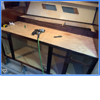

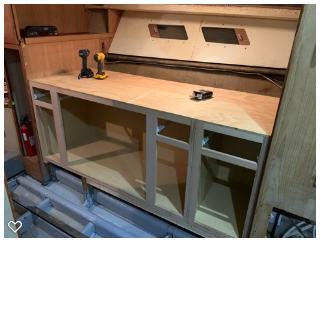

Well, tossed the 60" and 15" cabinet in, had to rip a 1/4" off the left and right sides, to make it fit, it was tight. Luckily the face frames have a 1/4" reveal, so sides went in flush. Going to make some doors for the back of the cabinet, sliders or something, so I can access that dead space back there. Thinking that would be a good spot for some inline water filters, that way if there's ever a leak, it won't wreck my beautiful MDF fake wood cabinet bottoms. :lol: Plywood tops for strength, instead of blocking for the countertops. Especially if I cut out a large section of the back, for the slider doors.
Definitely prefer this, over the ugly ass dinette that was there! Still need to frame up the raised backsplash area. And a billion other things.

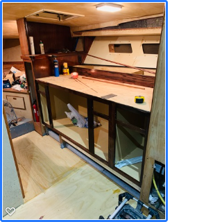

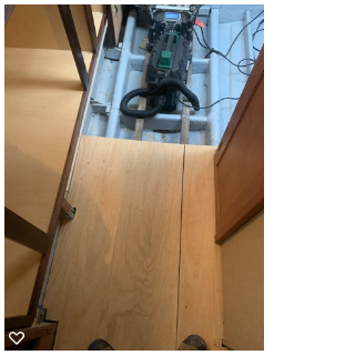

Haven't got a ton done lately, in the process of taking a new job and going to have to move roughly 150 miles, so getting that figured out with the boat and everything. Did manage to get some staining done, the riser area behind the counters, and floors in. Going to have the regular bilge access, and access to the bilge area under the stairs too, this way I was able to level the floors out a lot better, and used 3/4 instead of half. Soaked the bottoms in a couple quarts of poly, should last awhile. Showered plumbed into the new sump.
Just getting the other side of the kitchen figured out. Going to be putting in a washer/dryer all in one combo unit over there, a long with a 5-7cu ft fridge. And if I can make it fit, an over the range microwave too. Going to make this thing a tiny live aboard.
