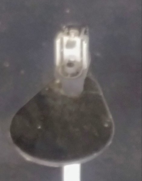

I have this light can anyone tell me whats missing or what to replace it with.

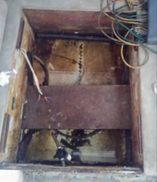

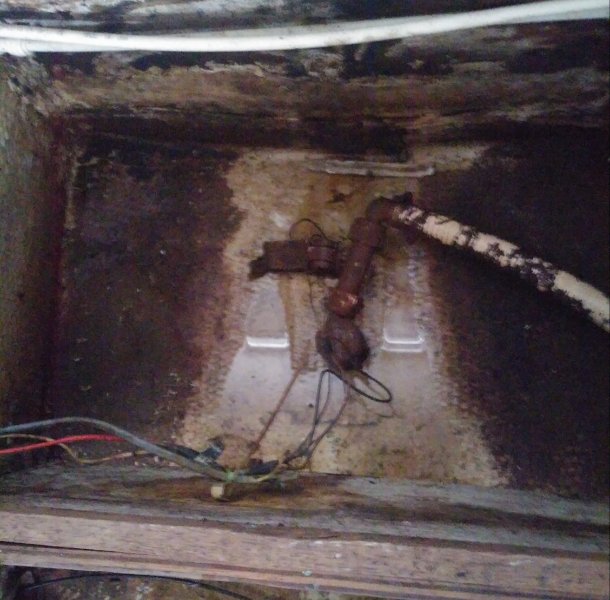

Also here is the compartment in my mid cabin with the tiny bilge and the fresh water pump was. Where should that pump be?
