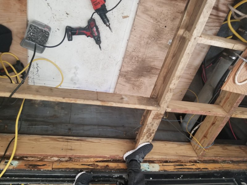

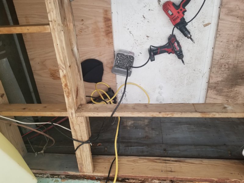

Here are some pics from today.

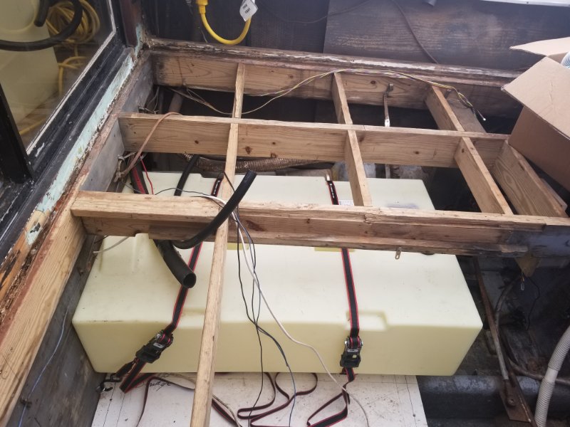

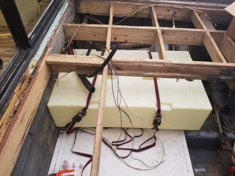

More pics
