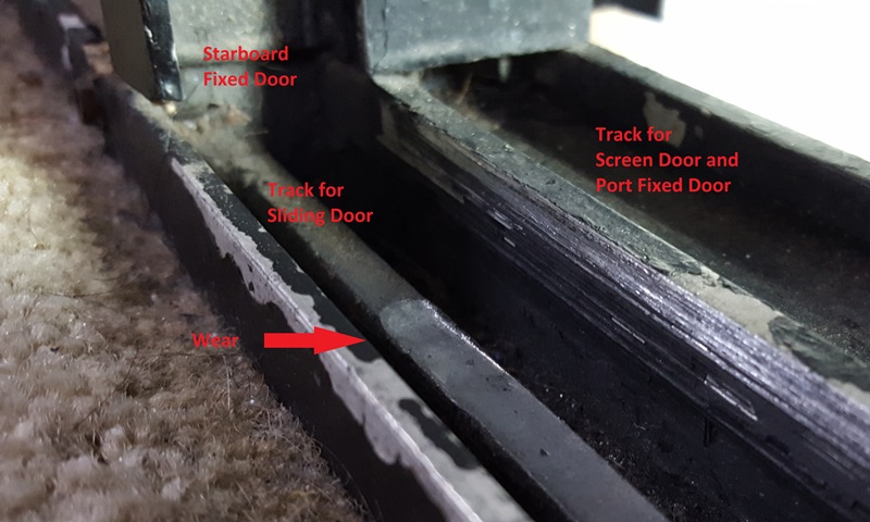

F36 Convertible Sliding Door Track
Re: F36 Convertible Sliding Door Track
prowlersfish wrote:captainmaniac The photo in my post is from your boat . Was the L bracket added ?
L bracket was original as far as I know (at least has been there since I bought the boat 16+ years ago). Don't think it is unique as here is a shot from the forum re F36 gas to diesel conversion that shows the same L bracket. http://i235.photobucket.com/albums/ee26 ... 0_0585.jpg
prowlersfish wrote:Are you sure your door is not just off track ? Just looking at the wear marks .
Quite positive. Where the track is not worn at all, it is flat on the top but with the original paint still intact. The wheels are also flat where they meet up with the track.
Due to the geometry, you could not put the door into the track without the wheel lining up with the raised portion of the track.
From the side, the portion of the track where the door rides looks like
I_M_I
with the sides of the M vertical and the top flat and below the tops of the I's.
It seems like Trojan used different tracks on different boats, or possibly ours was replaced at some time. I think I can repair ours for less than a new track would be, if I could even get one. Besides, I like fixing things rather than replacing them! :mrgreen:

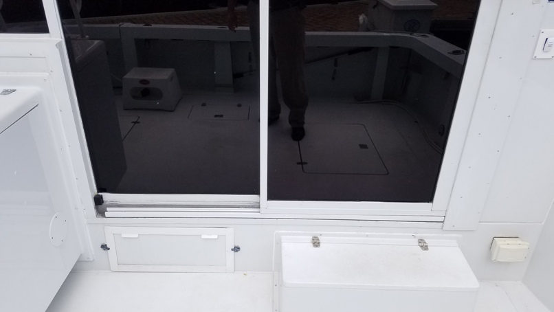

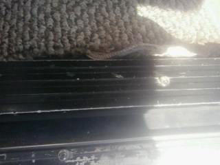

El L Sea wrote:The picture of the door frame (1st pic) is from the side on my workbench. I actually just slid the bottom part of the door off the glass and everything so I didn't have to haul the whole door home. The bottom picture shows the actual orientation.
The photo without the glass threw me off -- now I understand. How did you remove the existing track, or did you put the new track on top of it?
Thanks for the suggestion, I will think about all these when I can actually get back to the boat and see what fits the best.
I actually pulled the track and replaced it. I took some pictures today. Not too many since it was 85 degrees outside :D

El L Sea, thanks for the photos -- that is quite helpful. Not sure I could do exactly what you did since there are three parallel tracks that are part of the same extrusion on our boat, and there are fixed panels in two of them.

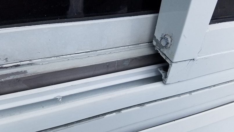

Here's a zoomed in version of the picture, and you can see the L bracket stopping an inch or so short of the door frame on the stbd side. I am guessing it's purpose was to stop as much cockpit gunk / dirt / leaves / bugs etc as possible from blowing or washing in to the wheel track.
L bracket.jpg (39.88 KiB) Viewed 7927 times
Have no clue what happened to Danny. Never knew him. Just found that picture by doing a search for "F32 sedan salon doors" or something similar.

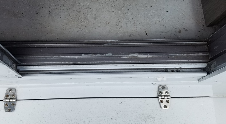

This what my track looks like . The door roller rides on the raised rail .

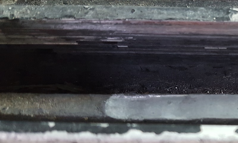

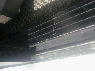

Here are a couple of photos of our door track. The wear at this end of the track is much less than at the other end.
As you can see, the top of the rail is basically flat. What you cannot see is that the rail for the screen door is identical to that of the sliding door, except it has no wear.
My play is to machine off some material from the top of the rail and replace it with fresh aluminum or stainless steel.
