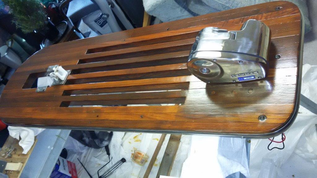

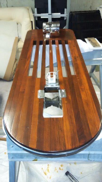

OK, It's done. I am going to reinstall it with the new windlass in a couple of weeks. That teak sands like granite! I sanded, sanded and sanded. I have about 7 coats of Cetol natural teak finish on it. I am pleased with the results. I just hope it puts up with the abuse, but time will tell.

Looks great! you wouldn't know that was the same pulpit.
The shiny stainless/polished hardware (windlass, edge band) really turns it up a level :)
