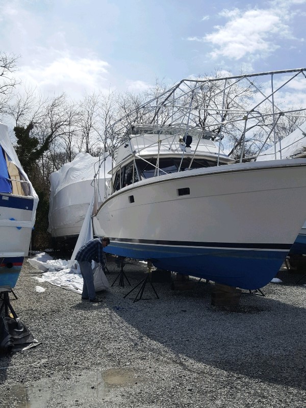

Another year has gone by and it is time for an update.
A few weeks ago, we had a major wind storm with gusts up to 70mph. It was one of the worst storms I have ever been in because of the length of the storm, the high sustained winds coupled with even higher gusts. Our house was without electricity for five days and it took a full day after the storm before we could get out to the main roads due to many large trees down across roads. If you are interested, there is some good info about the storm at https://www.washingtonpost.com/news/cap ... b4036a9c8a.
Anyway, due to the storm and a family vacation, I was unable to get to see the boat until this past weekend. The frame held up very well, but the tarp was off the boat with enough damage to it that I decided to trash it. There was only one significant rip, but many sections where the plastic sheeting was missing with only the nylon grid remaining. Many of the shrink wrapped boats appeared to have patches added to them, so it looked like the damage was widespread at the marina. There was no damage to the boat at all that I could see, which was great news!
I am pretty sure that the wind fully managed to get under the tarp at some point because a couple of the tie down ropes were broken even though the minimum breaking limit was over 1,200 pounds. It was quite impressive that the frame remained almost entirely intact and in place. There were two broken conduit connectors at the stern, but that probably happened as the tarp was torn off the boat.
I am not sure what we are going to do the next winter we are on the hard. The limited time to setup and take down shrink wrap is looking better now, especially since we are at a marina that does not prohibit doing it yourself.
In any case, I am quite happy this happened at the end of the winter just before the tarp needed to come off anyway!
- Tarp RIP.jpeg (170.88 KiB) Viewed 6190 times
