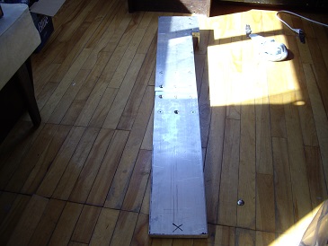

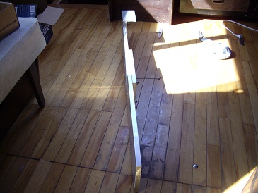

Last week, I got some aluminum plates at Metal Supermarket in Ottawa. about 7" high by 3/4" thick by 4 feet long. Times 4 for both sides of the boat. I used a non ferrous circular saw blade to "rip" the material to size. Since the access is limited, I had to cut my 4 foot lengths to 2 feet long and make a backing plate the affix both lengths together once in place. Here is a dry fit to check the bolt pattern before going in.

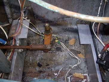

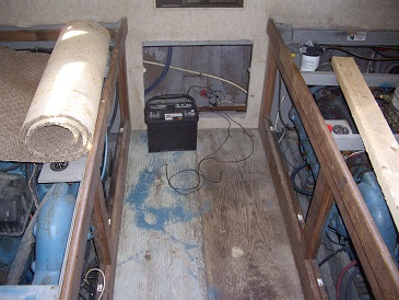

So, Step 1, empty the bilge and remove the carpet in the aft cabin...
IMGP2031 remove carpet.jpg (108.37 KiB) Viewed 9022 times

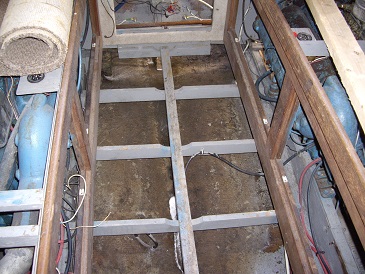

then, step 2, remove the floor!
IMGP2032 remove floor.jpg (116.12 KiB) Viewed 9022 times

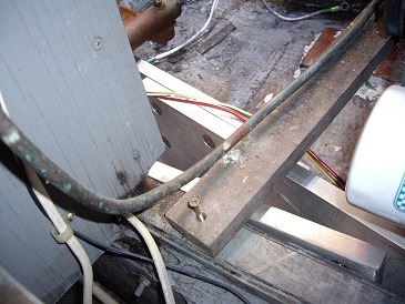

Step 3, shimmy the first piece in place.
IMGP2036 dryfit1.jpg (111.26 KiB) Viewed 9022 times
Step 4, Shimmy the second piece in place

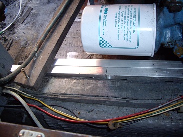

Once all was bolted and torqued properly, I clamped the assembly in place ready to drill the stringers and plates.
IMGP2047ready to punch.jpg (121.29 KiB) Viewed 9022 times
I then drilled the stringers with the plates in place, removed everything and drilled the aluminum plates separately and replaced everything back in their final resting place ready to bolt. I have not bolted it in place as I forgot to measure the thickness of the final assembly last time I was at the boat... :cry:

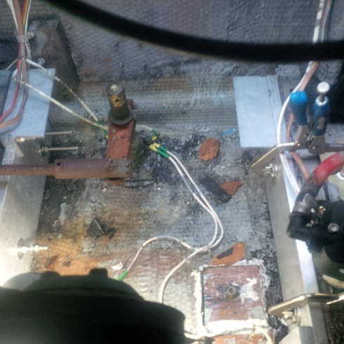

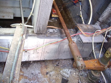

OK! I am back at the boat. Sunday, I realized that some aluminum plates did not fit. I had not counted on some unforeseen obstructions. I re-measured and modified the plates. Ordered bolts, flat washers (oversized fender type at 1-1/2 inch in diameter), lock washers and nuts to affix the plates to the stringers. the plate on the left side, in the picture below, is loosely fitted ready to bolt permanently and torqued. I just need to cut the bolts down a bit to make a tidy install. the plate on the right is in place and needs to be drilled to receive the bolts. Hopefully, all the plates will fit fine this time around... sorry for the picture quality. I thought I had everything for the day. Obviously, I forgot the camera! So, I used the phone. :?
Access is a bitch as most of the bolts are located under the engines and all the grounding wires are run inboard of the stringers... :shock: Oh well, that is part of the fun :(
I should be able to complete the work tomorrow if I survive the night! It is supposed to be 3 deg. C tonight. I will let you know how it goes tomorrow.

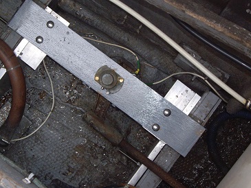

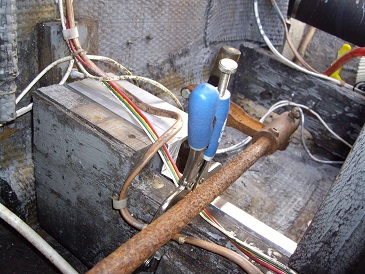

I thought I would report on the last step of the rudder support replacement. I am happy to say that the job is complete for the most part. I was able to cut the white oak to size, cut a hole for the bearing, bolt it in place and paint them with bilge paint. Again installing was difficult due to the limited access...
Some of you may notice that the spring pin is not completely in :shock: . I only had a hammer to push it in and feared that I would bend it out of shape or break it. I will need a "C" clamp to press it in properly. All I need to do now is properly attach and support the grounding wires that I removed for access.
Hopefully this thread will be helpful to someone in the same predicament.
