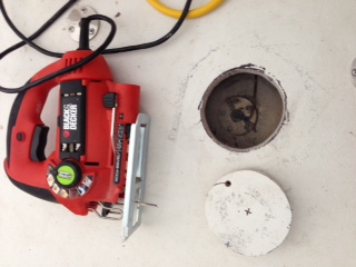

I know, nobody likes to cut a hole. Theoretically it is probably possible but would be a nightmare. I would like to hear from someone that's really pulled it off. I can tell you that the fuel sender is 24 1/4" back from the lip of the cockpit hatch with about 3" of clearance from the top of the tank to the bottom of the deck. It would be tough. The good news is that there is a support stringer/brace that runs across the beam just about an inch aft of the hole, so there should be some pretty good support there. The sender gasket and corosponding mounting holes only fit in one way and really need some care to be torqued down just right to prevent leaks or over squishing the screw gaskets.
Fuel Sender Hole.JPG (34.58 KiB) Viewed 1984 times

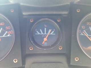

I was pretty happy to have nice access to all of this so that I could really see what was going on in there. It would be tough to get that thing in without bending either the bracket or float wire. It's the little things that make you happy, but I was pretty thrilled to see a working fuel gauge today.
Fuel Gauge.JPG (30.38 KiB) Viewed 1984 times
