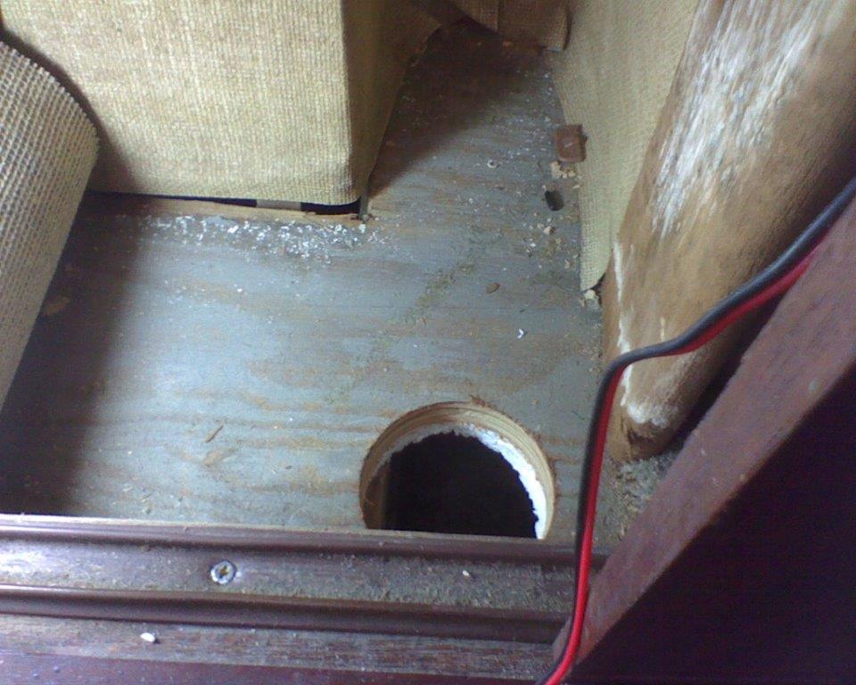

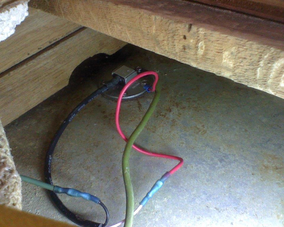

Sender installed
Sender seen from out side of cabinet
sender 1s.jpg (106.56 KiB) Viewed 14900 times
3" hole to install sender (offset a few inches)
sender 2s.jpg (104.83 KiB) Viewed 14900 times

Maybe those diesels are wider than my Mercruisers. My tanks are wedge shaped and I think the sender is offset to the inboard side. I have the extended range tanks below the cockpit, those gauges are next. Looks like you did a neat job, which is no surprise.

The tanks where replaced when repowered with the diesels . The OEM tanks where galvanized the replacement are aluminum . So the senders maybe in a different location then the OEM . Or perhaps the moved them inboard in the newer F36s , mine is older then yours .

prowlersfish wrote: Sat Apr 05, 2014 7:08 pm Just up graded my fuel senders to a wema unit . Finely will have fuel gauges that will be correct .Only had 1 working gauge before and it was way off when it worked . ( I always keep track of fuel used )
The new Wema is to the left .
Lots of fun to replace on a F36 :wink:

I am sorry but I can't be much help. The ohm range matched my VDO gauges that are not original on my 77/78 boat. Sender needs to match the gague. I don't remember the leanth as it was 8 years ago and the tanks are not original anyway.( Replaced when depowered to diesel) To find the leanth I pulled the sender and measured to the tank bottom. Beacon does sell the swing arm style pre adjusted to fit the stock tank fwiw. Sorry was not much help.
