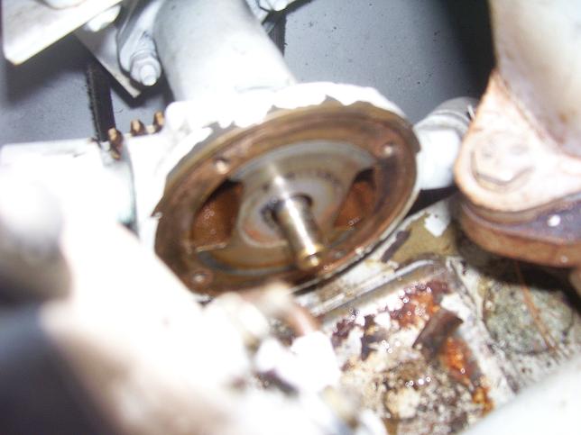

Couldn't get the Onan to pump though. Opened up the water pump housing and found the answer. The impeller was so worn it was not only swollen and had taken a hard set, but had spun free the bearing from the hub, and the input shaft was just spinning the bearing inside the hub. No worries though. Impeller and gasket kit on the way. I'll just have to live off the inverter if I decide to go out in the next few days.

ahhhh that infamous onan impeller and pump.
mind did the exact same thing the first week i had her. spun that sucker right off. actually, the pulley set screw vanished and the assembly moved to where it just created a nasty scene. john, my mechanic, simply dug around his 'parts department' and produced a gently used replacement pump. he even had the correct impeller!! he said i had to reinstall it though as he wanted me to earn my keep. i could hardly refuse the offer.

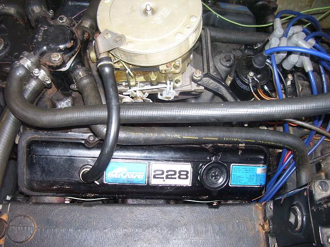

Heres the proper color factory power. This is the Stbd. The one that has a long time documented history of issues. Basically whats wrong with it is that its a 305 Chevvy with flat tappets, a Rochester and old skewl ignition. If ya give it 'The Fonz' it generally runs good. (i.e. kick it and it purrs
