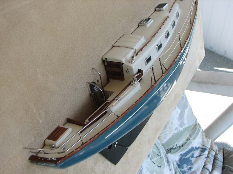

Anyway, you get the idea ... need to be creative when scratchbuilding. I've built a lot of model racing cars, Flying Scotsman loocomotive, several sailboats including our own Alberg 37 (below) ... yes I'm a sailor!!
Frank
Yes, it was built from scratch ... every last bit of it.
I couldn't find any proper drawings of the boat so I scoured the web for shots at good angles and converted them to line drawings (available if anyone wants to have a go). I spent a lot of time aboard Honey Bear taking hundreds of photos and measurements too. Took me a long time to get the hull correct as there's a lot of tricky shapes built into it.
Made all those 60 and 90 degree fittings that hold all the railings.
Somef pieces were turned on a little lathe using Exacto blade handles ... it's a fairly soft aluminum and made the air horns, seat supports and windlass.
Used silver solder to make the ladder to the bridge ... that was fun!!! Ordinary solder works but is too weak and blackens quickly.
Found that the dark plastic used in welders masks was perfect for the windows ... not too thick and dark enough you can't see the mess inside the hull.
Made all the decals (boat name, registration numbers etc) from photos and printed on decal paper.
Bowsprit and swim platform glued up from many thin strips of mahogany.
Frank

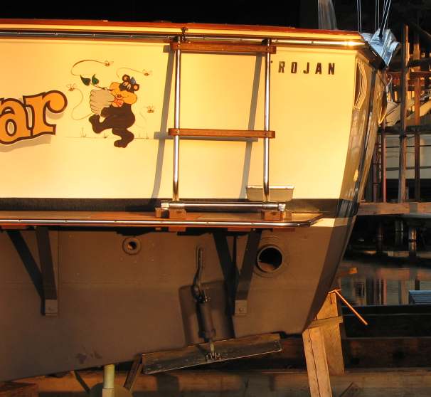

I just know you're now going to ask me "where's the little ladder on the swim platform?"
F
His boat doesn't have them. An early 70's model.
F
