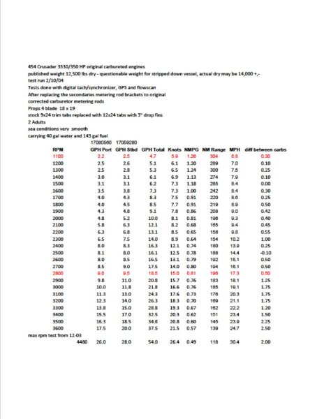

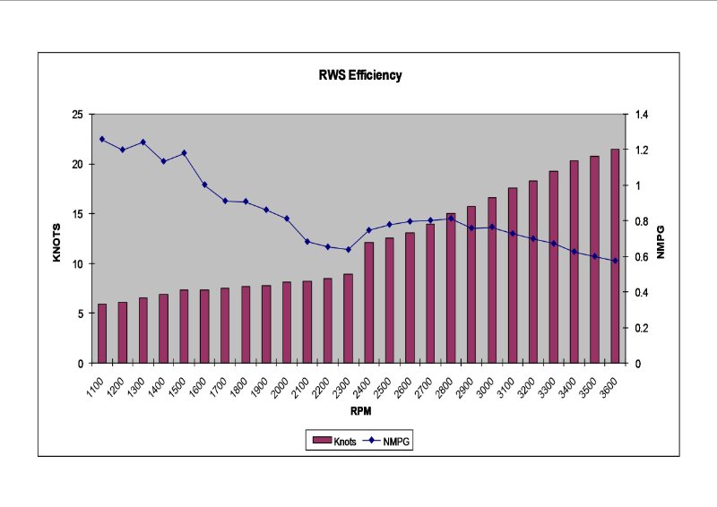

Attached below is the flo scan results of my 4 blade props with the gas engines before the diesel refit
Really not too shabby when one considers the actual VOLUME of this vessel.......
