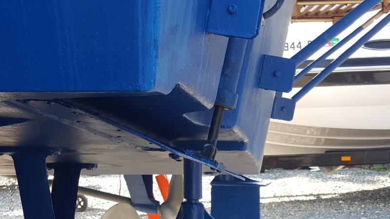

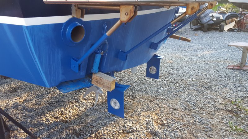

Here are photos of our trim tabs on a '75 F-36. As I recall, our boat is about the same year as Oil and Water's was.
And if you zoom in, you will be able to see that the prop nuts are backwards. That is the way we got the boat and I have not had a reason to take them off, but when I do, they will be installed correctly.

WayWeGo,
Are your swim platform brace arms just regular bolted stainless tubing? Or welded?
Re: What’s wrong with this picture?
Posted: Mon Jan 06, 2020 10:19 am
by WayWeGo
Its all regular stainless tubing. I suspect it did not come from the factory, but not sure.

WayWeGo wrote: Sun Jan 05, 2020 2:48 pm Here are photos of our trim tabs on a '75 F-36. As I recall, our boat is about the same year as Oil and Water's was.
I am going to recheck with Bob and John on the tabs

Briank117 wrote: Thu Jan 02, 2020 3:48 pm Anything look off here?
Maybe the pic angle, but to me the rudders seem much larger than what we had on our 78 F32, which is a good thing , and our tabs were mounted on the transom like instatrim directions.

The recessed trim tabs on WAYWEGO's boat and The F36 photo I posted were indeed Trojan factory . The early ones were billed as a "SportFish" . You will notice beside the cylinder the tabs a recessed in the bottom also . I wish mine were like that .

Usually when a hull is designed to accommodate mounting trim tabs on the bottom of the hull, the mold incorporates an indent for the tab hinge to be mounted in as seen in the above photo.

Interesting. The tabs on my F-32 are mounted on the bottom. Original as far as I know. Boat Leveler '82 Hmmm..
