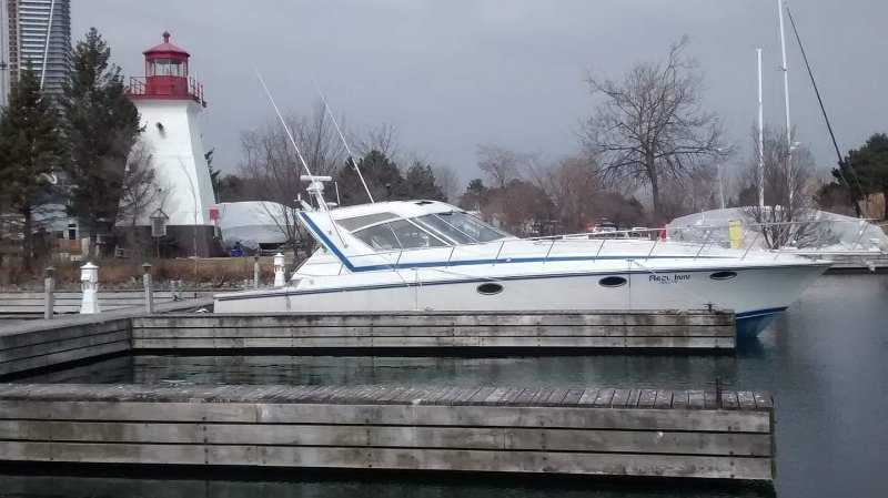

Posted: Wed Apr 10, 2019 6:38 am
You can see how big a 13 meter is in that photo . Nice
