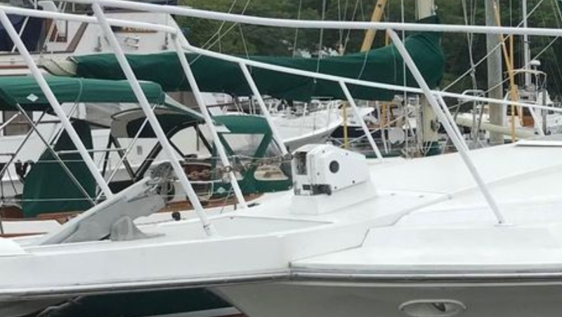

I really wanted to go with a vertical windlass but the more I research it just doesn't look possible. The 12M express pulpit is not flat unlike the convertibles. In order for a vertical windlass to work the unit must be level with the roller. From the pic of another 12M the windlass is mounted on a tilted area which makes the vertical windlass a problem. If I put in a filler piece to level the unit I run into a depth problem. Pulpit plus a small gap plus the decking is about 5 inches. Good automatic windlass can only go up to 7 inches with the extension. This block on the SeaWolf is about 4 inches. I would need about the same thickness to make the chain level as required. So I think I can only install a horizontal windlass. Heading to the boat show next week to talk to Good Automatic Windlass to see if there is a solution.

Almost done. I realized from the top picture that the piece of wood that was in there actually split when I took the pulpit apart. I thought it was two pieces of wood that joined together. It was actually 5200'd in there. I had to chisel out the 5200 and the wood. Cleaned up everything.
Good recommended I use their off- white spacer block to make up the angled adapter but the boat was stark white. I glued two pieces of 100% PVC called Azek. Basically trim boards for houses which is out in the sun all day and won't degrade. Made an Autocad file and cut the pieces out on a CNC router. Scribed the angle I needed and cut it on a band saw. It went from 2" down to 1/4". Drilling holes in my new pulpit was tense. Measured 4x and cut once. I put spaced blocks in the gap between the boat and the pulpit so when I tightened down on the bolts it wouldn't just squeeze the two together. Put West System on the exposed wood and dropped the unit in. Definitely needed the extension kit from Good to get the unit to reach the rope locker.
