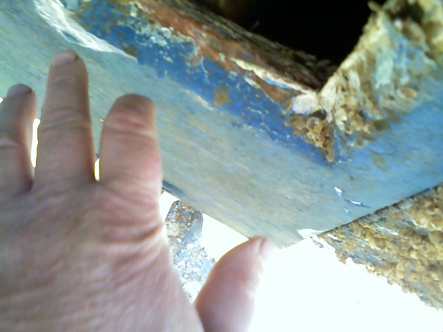

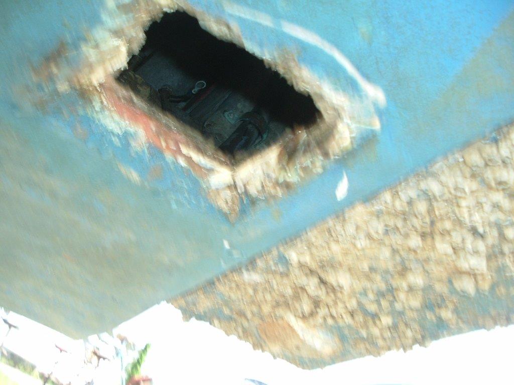

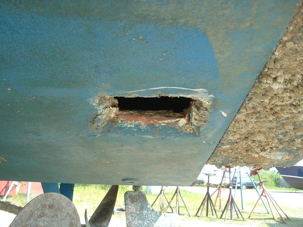

Re: Rudder bearing removal
Look at that area real close . It is the weakest point in the hull , yet its under stress . A bent rudder shaft can flex the hull to the point failure .oil&water wrote:At one point I was waiting for the whole rudder mount to drop through the bottom of the boat. It was not a good feeling at all watching the entire back of the hull shutter with each hit. Old barnacles were falling off the vibrations were so intense. I have a whole new respect for fiberglass' strength.
4"X6"
- hull failure.jpg (86.25 KiB) Viewed 8764 times
- hull failure 2.jpg (140.37 KiB) Viewed 8764 times
- hole in boat.jpg (75.05 KiB) Viewed 8764 times
Wow! That is a sad sight. I will examine that area very closely. I've seen so many boats go down due to rudder strikes.

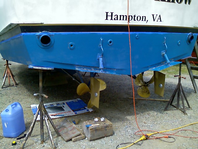

It can be fixed
- rudders 1.jpg (113.85 KiB) Viewed 8760 times
