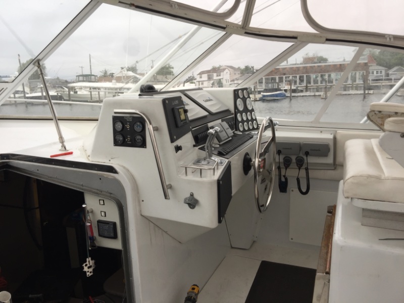

Garmin discontinued their 8212 series and certain dealers were selling them for real cheap
I picked up 2 and sold my 7212 plotter
Upgrade only cost me $1500
Finally I get a good deal lol

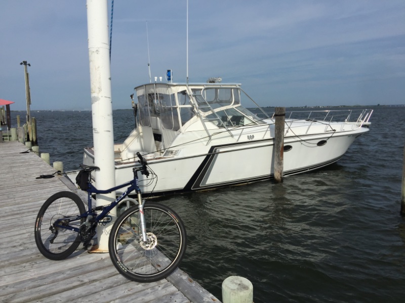

Just some updates on the Trojan. I continue to push forward with getting the vessel back to working order
The 2018 season was the best yet for me and the boat. The Detroits have over 200 hours now since they were installed and run really good
I spent a lot of time this Summer on Fire Island, docked at Watch Hill, Kismet and Sailor’s Haven/Sunken Forest.
- 6F9AD67C-A613-4390-87E7-578A7E9AD57E.jpeg (161.7 KiB) Viewed 12980 times
- FF82C660-A579-47A8-B42A-84C4B1FD9A10.jpeg (147.05 KiB) Viewed 12980 times
- 317B7314-DB6F-4E79-8C4F-143EE67EC47E.jpeg (146.13 KiB) Viewed 12980 times

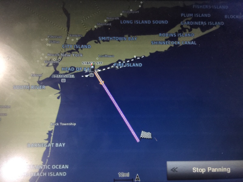

We took the boat off shore for the first time this Summer, it was a beautiful day and an awesome trip
About 40 miles South of Jones Inlet

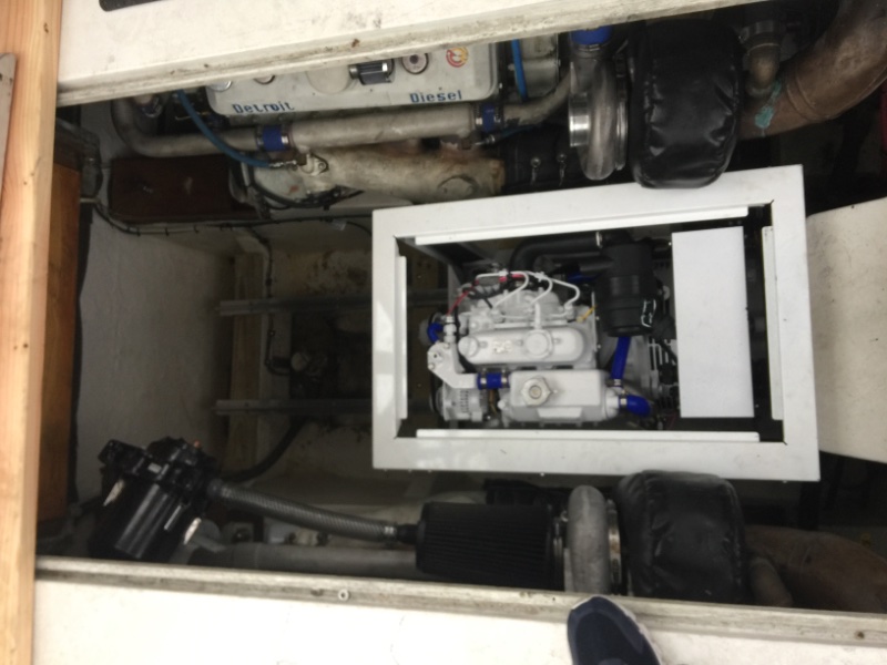

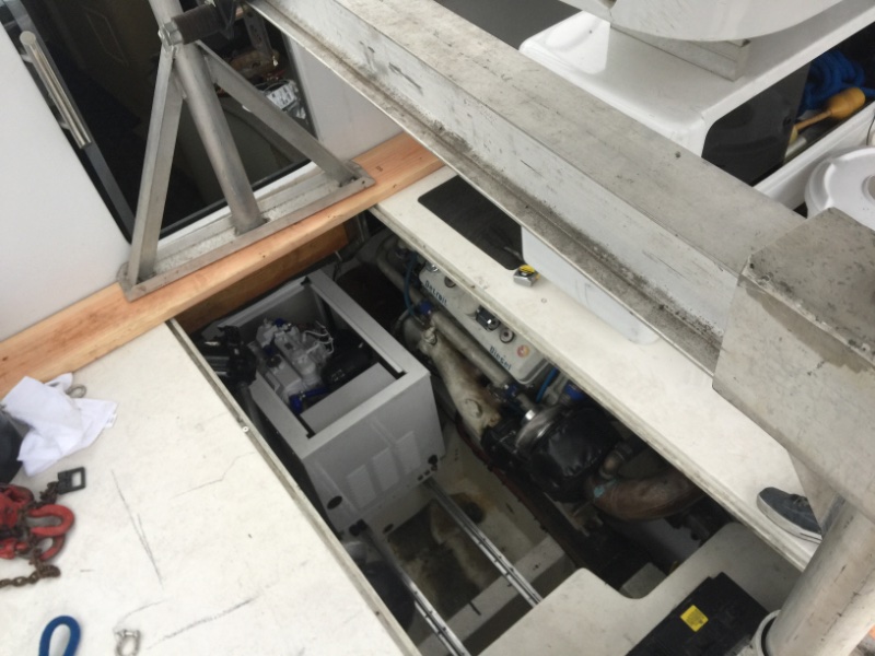

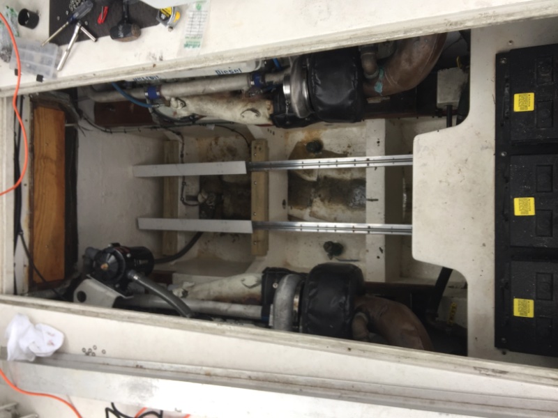

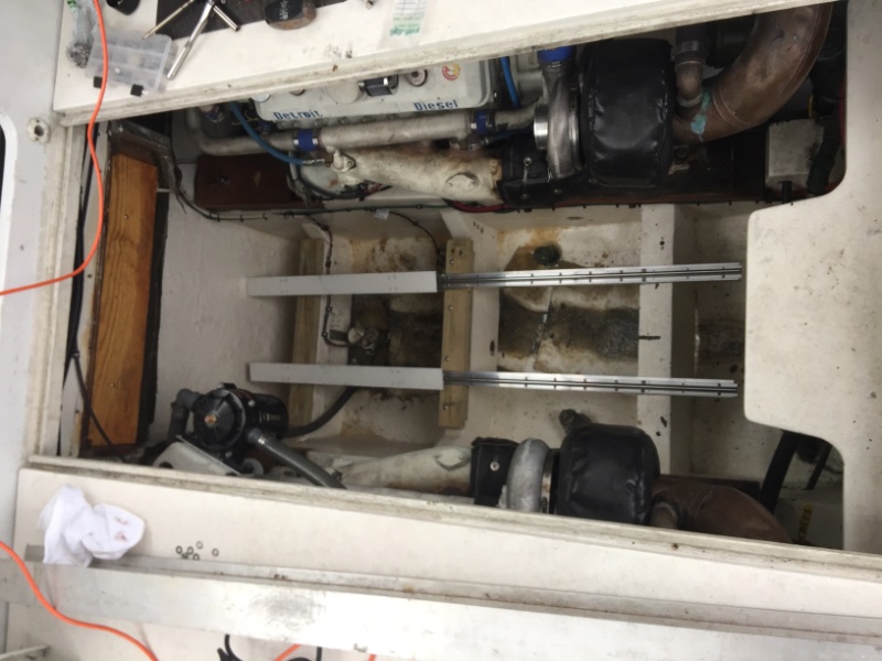

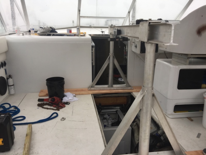

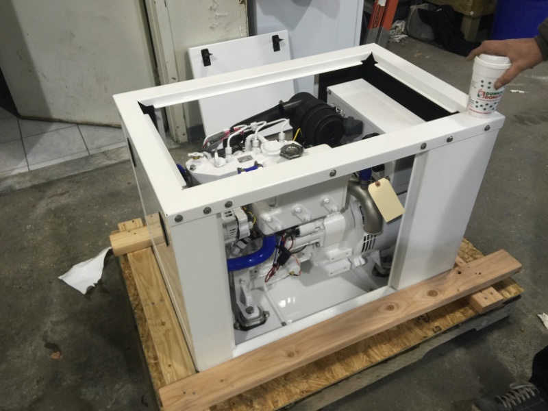

This was a big upgrade for the boat
9.5 kw Phasor Marine w/ a Kubota engine
It’s a really tight fit between the Detroits, and very difficult to do maintenance on everything with the geni there so I installed it on rails

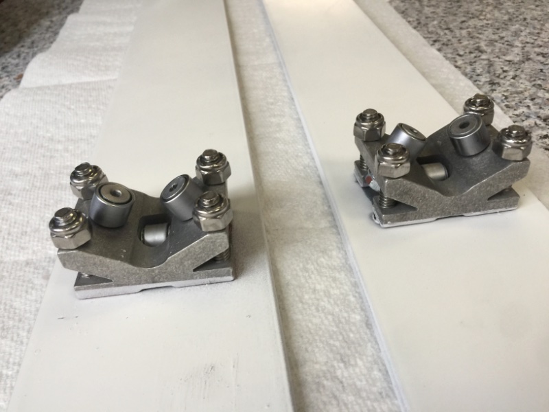

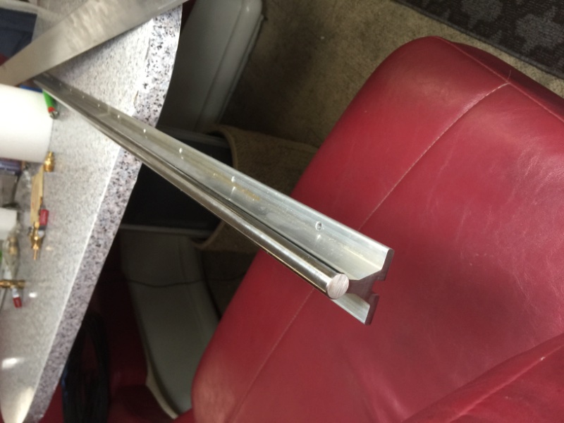

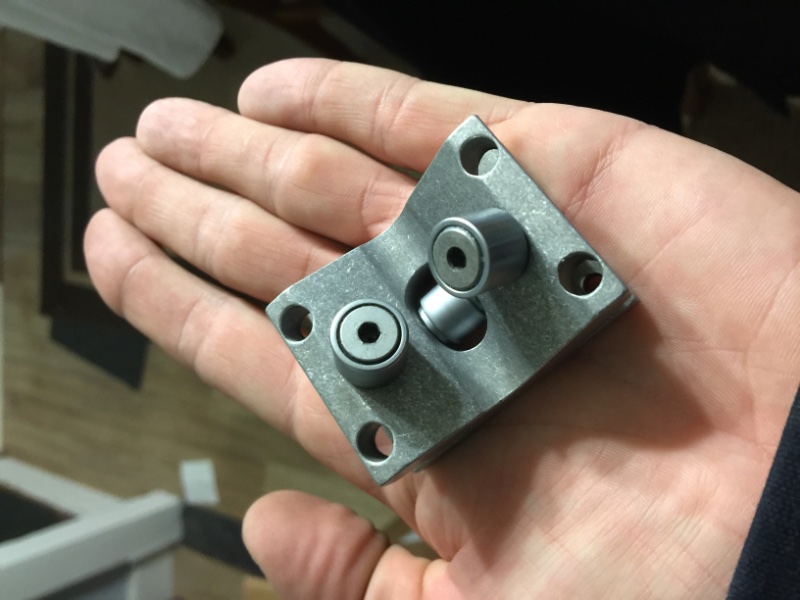

These are roller blocks that go on the rails
- 6F7E7C99-4F77-4C6A-B2C2-ACF7101DCED8.jpeg (120.49 KiB) Viewed 12984 times
- 6CFE499B-C11D-42DA-9C05-09E86C956B3A.jpeg (107.24 KiB) Viewed 12984 times
- DD3C42E6-5EB6-472A-BB3E-33BE00CBF854.jpeg (109.09 KiB) Viewed 12984 times

I spent about $9500 for the geni and hush box with freight
$2500 for rails and roller blocks
$500 for hardware and exhaust
Absolutely worth the extra money to be able to move the geni
I am 6’1” and I can sit in the bilge in front of geni for maintenance

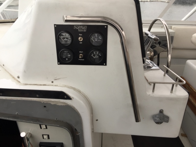

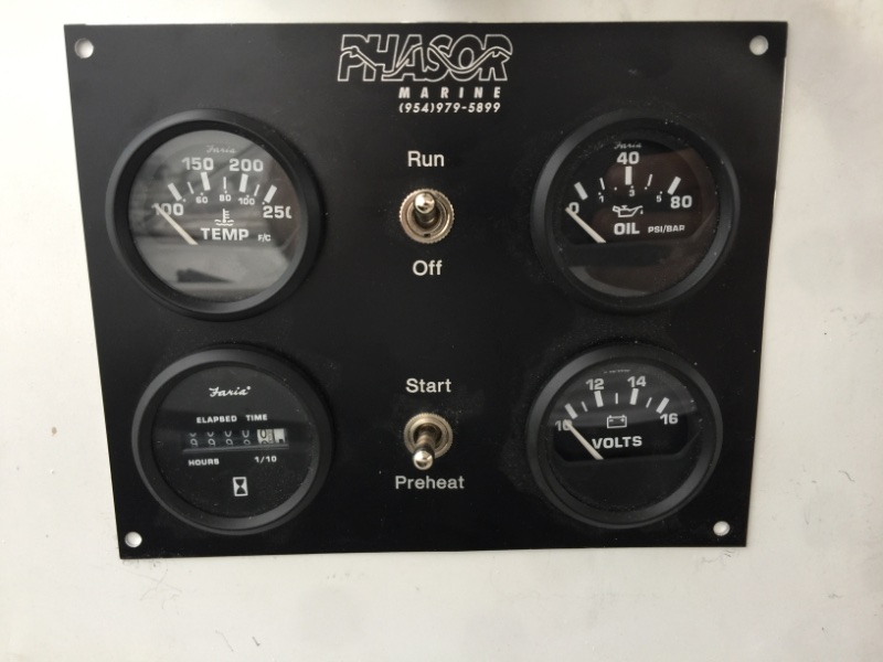

I bought the remote panel, it worked out great and is very easy to watch the gauges
