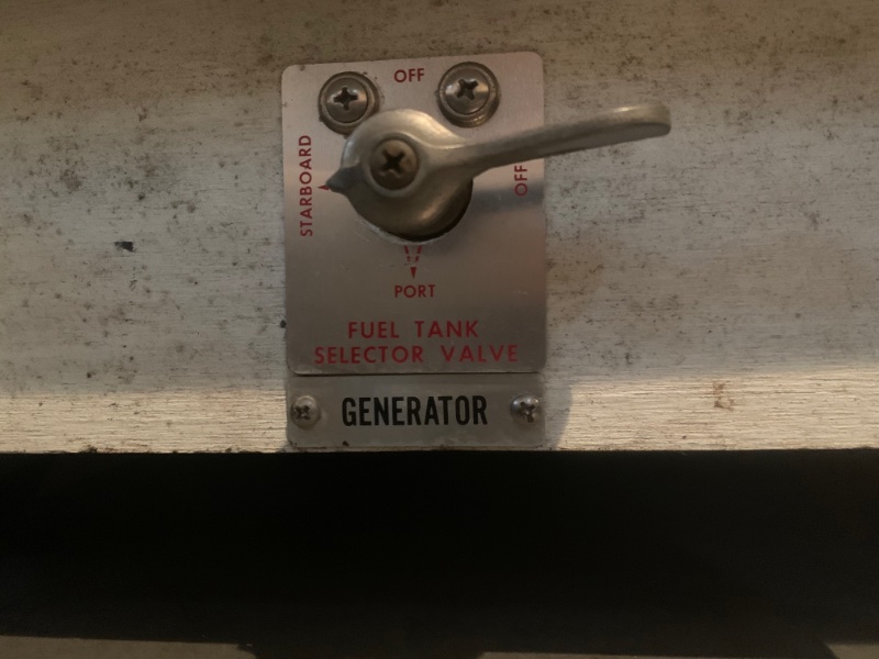

Re: 1996 390 Express fuel selection
Thanks for the reply. Tanks are set up between mid ship and aft on both port and starboard. There is one crossover valve that I can find that is a three-way valve. It has an incoming line from each tank port and starboard, and one outgoing line to the generator. Valve is accessible from mid cabin. I am not able to find any other valves off of the fuel tanks anywhere. I could post a picture when I get to the boat tonight.
This is the only valve I can find regarding fuel.

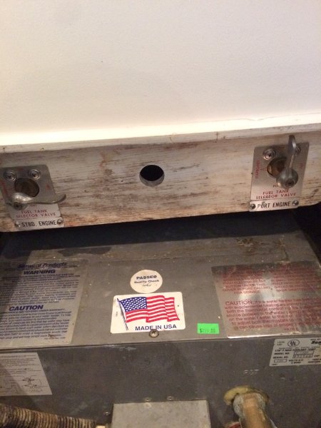

- Posts: 792
My Trojan Express is NOT a diesel. Mine has the 502 Bluewater engine option and was also upgraded to a 7.5 Westerbeke generator.
The boat has two fuel valves. One for each gas tank. The valves are located on the bulkhead behind both engines. This bulkhead is accessed inside the cabin by removing the cushions on the settee in the cabin's rear lounge and then removing the hatch cover.
I assume that your single valve is located on the same bulkhead.
There is a hole in the middle of my fuel-valve dashboard (see my photo) and this seems to be where your single valve (marked "Generator") is positioned. Maybe your current valve still feeds your Generator. (You can choose to send fuel to the generator from either tank.)
When my stock generator was removed by the selling dealer and replaced by the Westerbeke unit, they chose to feed it from the starboard fuel tank for some unknown reason and eliminate the middle valve (marked "Generator.)
I am going to assume that for some reason your tank selector valves have been either moved elsewhere on the boat (doubtful) or eliminated completely (are the empty holes still there?). A new valve system feeding each engine separately has probably been installed.
Hey Rick, thanks. I’ve followed the fuel lines from my tanks to the three way valve that is existing. I’ve looked at every line from the tank. There are no other valves in the fuel system on my boat. There are no empty holes where valves previously were located
- Posts: 792
Hi,
Well, that's a weird one.
It would seem to me that if the valve we are looking at is operative - it is indicating that it is adjusted to send fuel from your starboard tank to your generator.
Obviously, your engines are receiving fuel from "somewhere".
When you trace your fuel lines backward from your engines, I'd be curious to hear where you end up?
Good luck.
