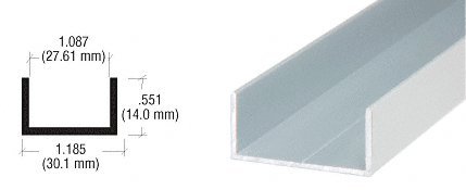

Here's a pic of the dimensions for the u-channel in case that Amazon link doesn't stand the test of time. I also forgot to add that I decided not to seal the mating surfaces between the aluminum and plastic hatch but may do so in the future. I plan on using 3M Fast Cure 4000 UV for its bonding strength to both plastics and metals.
