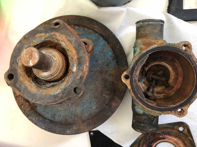

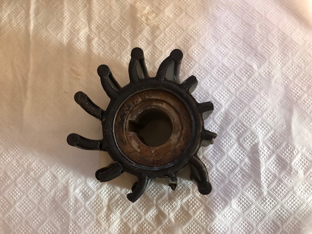

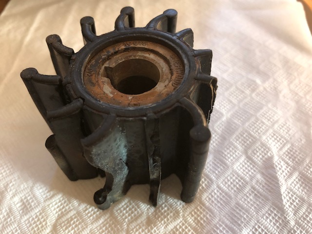

The second boat was on our F-32. I had noticed a slightly hotter temp on the port engine and had steam in the exhaust. Infrared readings showed the engines operating at the same temperature at the thermostat housing. Supposedly the previous owner had the impellers changed about a year and a half ago with only about 60 hours on them. I have put another 60 on them myself. So I figured it was a gauge issue and that the steam was oil burning, which I knew was a slight problem on that motor. Fast forward a few weeks and the temp had gotten hotter than usual on a quick evening jaunt. I pulled the water pump yesterday and found a gnarly mess. The impeller was clearly older than stated and the blades were chunked up from the brass diverter. The pump was a hot mess. The bearings had dislodged and were stuck inside the housing neck in a rusted mess. The inside of the pump had extensive rust and calcium buildup. Fortunately I caught the mess before a complete failure happened. While not as catastrophic as the Cummins equipped boat, it still could have snapped belts and ripped off the fuel line and throttle cable. I had spare pumps so I will be changing this one out and rebuilding the original for later use. I am also replacing the raw water intake hose from the strainer to the pump as some degradation was noticed on the rubber outer shell.
Be sure to clean out your heat exchanger or engine passages if the impeller is damaged as those pieces of rubber have to go somewhere. If left in there, they can clog up the small passages and restrict water flow.
Moral of the story, check your raw water pumps and make sure the bearings do not have excessive wear. The impellers should be checked and replaced if any signs of wear are present. The shafts should not have any side to side play. If they do, rebuild or replace the pump. If you rebuild them, it will require the use of a press to separate and install the bearing and shaft.
