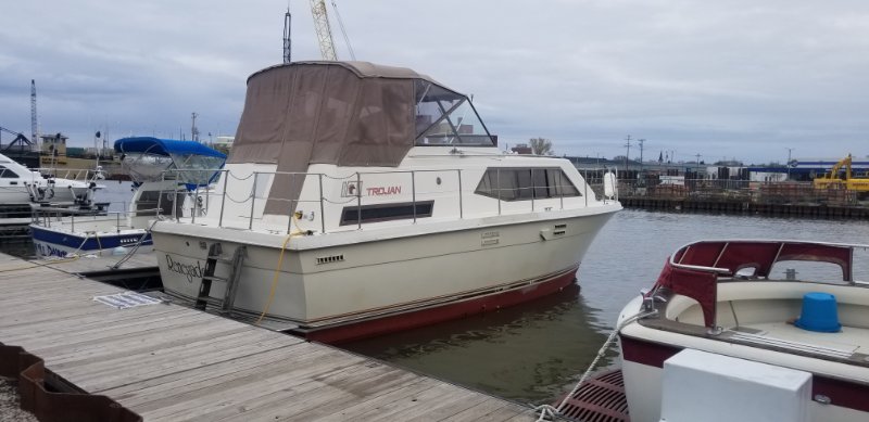

Any suggestions? Also, here is a picture. She will be renamed (the hell with bad luck renaming a boat, that's my middle name)...
