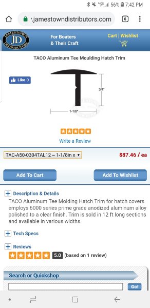

You did the framing out of the plywood as well? Thats interesting. I didnt think of doing it like that. That will rexuce my wait time. As far as a trim what did you decide on? Im thinking this.

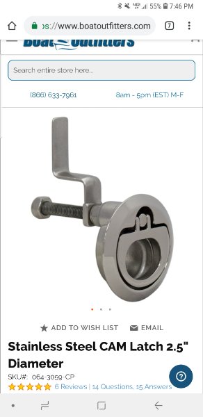

Then im going to use these with rubber gasket around the whole trim to make it water tight when the cam compresses.
