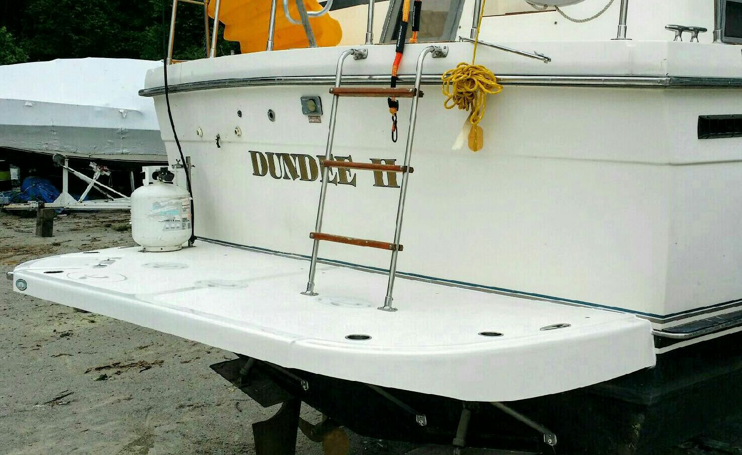

Thank you! We love it. It's fully composite with a 15 year warranty.
It weighs about 1.5 lbs per sq ft, vs 4-5 lbs per sq ft for traditional plywood based platforms. And the pricing is right in line with the traditional ones! It's based in Quebec, so a deal for Canadians and with exchange rate a steal for Americans.

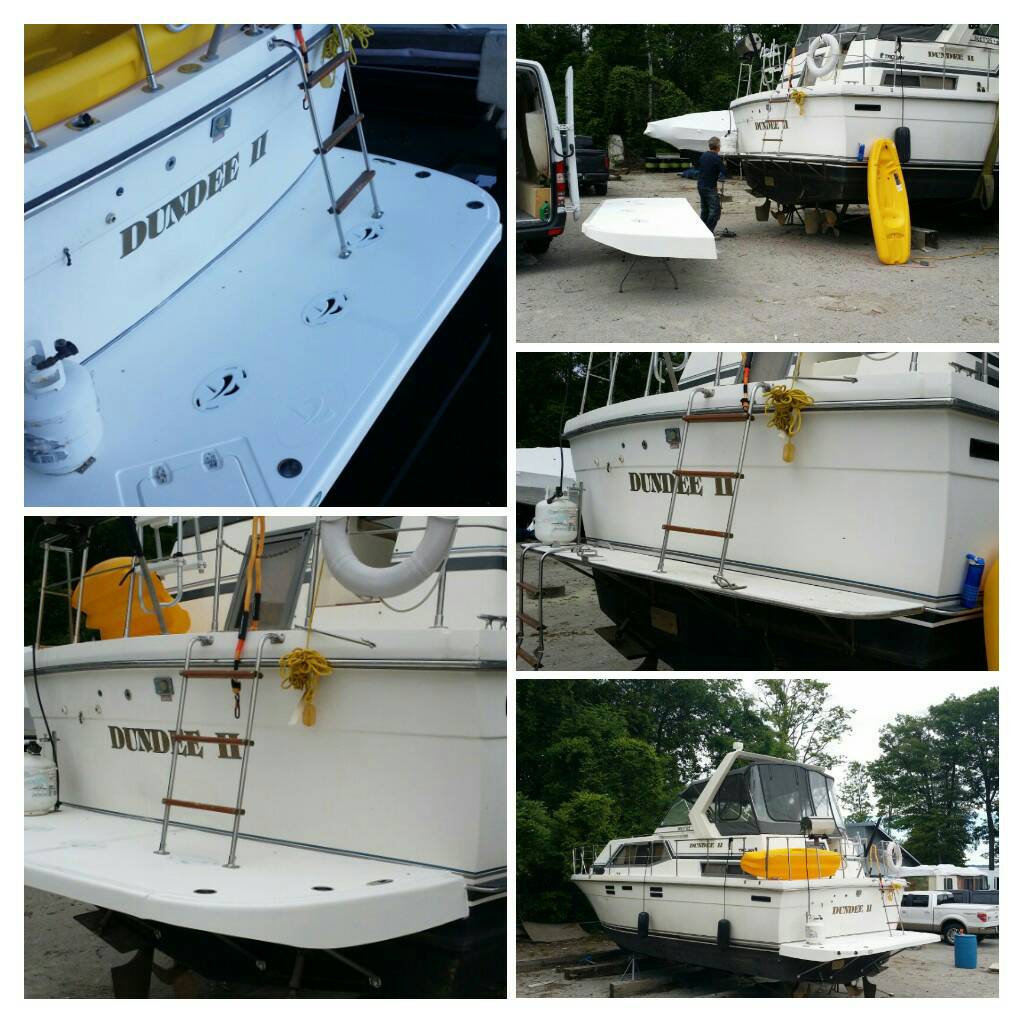

tdogg wrote:I forgot to upload the new swim platform that we had installed in May 2016, there was a delay and size correction required. But it finally arrived and was installed. It's awesome, such a difference. As you can see, we went from a 20/24" deep platform to a 48" deep composite platform. At 11.5' wide, it's a much more usable area and a great hangout area.
Here is a collage, I will upload a before and after to provide more details for those interested.

I had them install it on top of our old one as it was still solid. They added 4 stainless steel braces. They said with that install I could have 10 people on the back if I wanted :-)

Have you had a chance to take a run with it yet? With it being extra long, how well does it clear your wake / stern wave? I have seen some boats with massive platforms, and have always wondered about them being too long and getting hit by the stern wave rising underneath it and put huge strain on fasteners and the transom... kind of like a 13' wide x 4' long extra trim tab!!

Excellent question. Yes we have travelled with it and it clears wake nicely
The height of the edges are customizable. I kept it wider, all good so far.

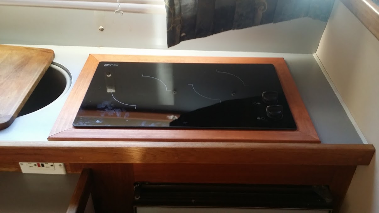

Upgraded the cooktop, the old one cracked.
Whale Seaward Princess 2 Burner Cooktop 120V Pencil Edge 2247-5100

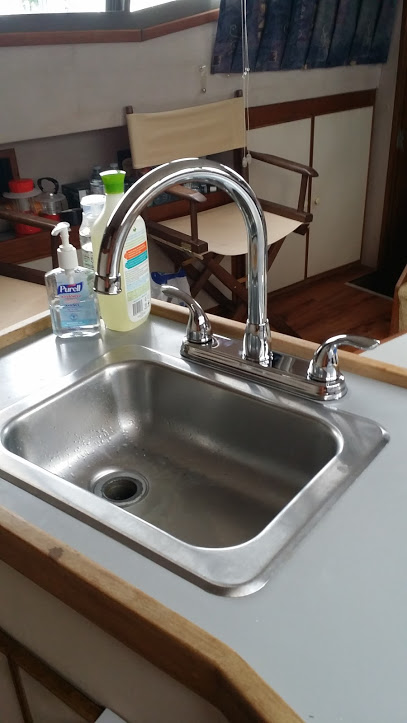

Upgraded the galley faucet with higher arch, definitely makes the sink easier to use, should have done that years ago! And the Aft cabin head faucet upgraded as well

Lovely upgrades! I did the bathroom faucets as well. Getting a higher sink faucet is now on my short list!
