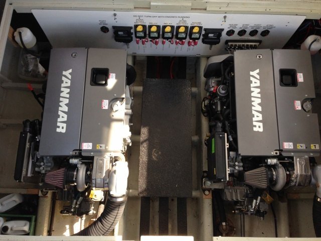

by DAVIDLOFLAND
engines (1).JPG (65.23 KiB) Viewed 9517 times
Five seasons and about 1100 hours later, not a trace of remorse.

Those look beautiful.
And holy _ _ _ _, 220 hrs a year in Alaska?

by DAVIDLOFLAND
Over 200 hours per season of early April through mid September. No sense in having a boat to only sit in a harbor. :D
