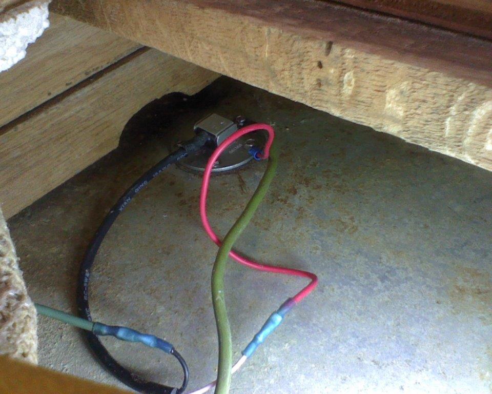

Sender installed
Sender seen from out side of cabinet
sender 1s.jpg (106.56 KiB) Viewed 14698 times

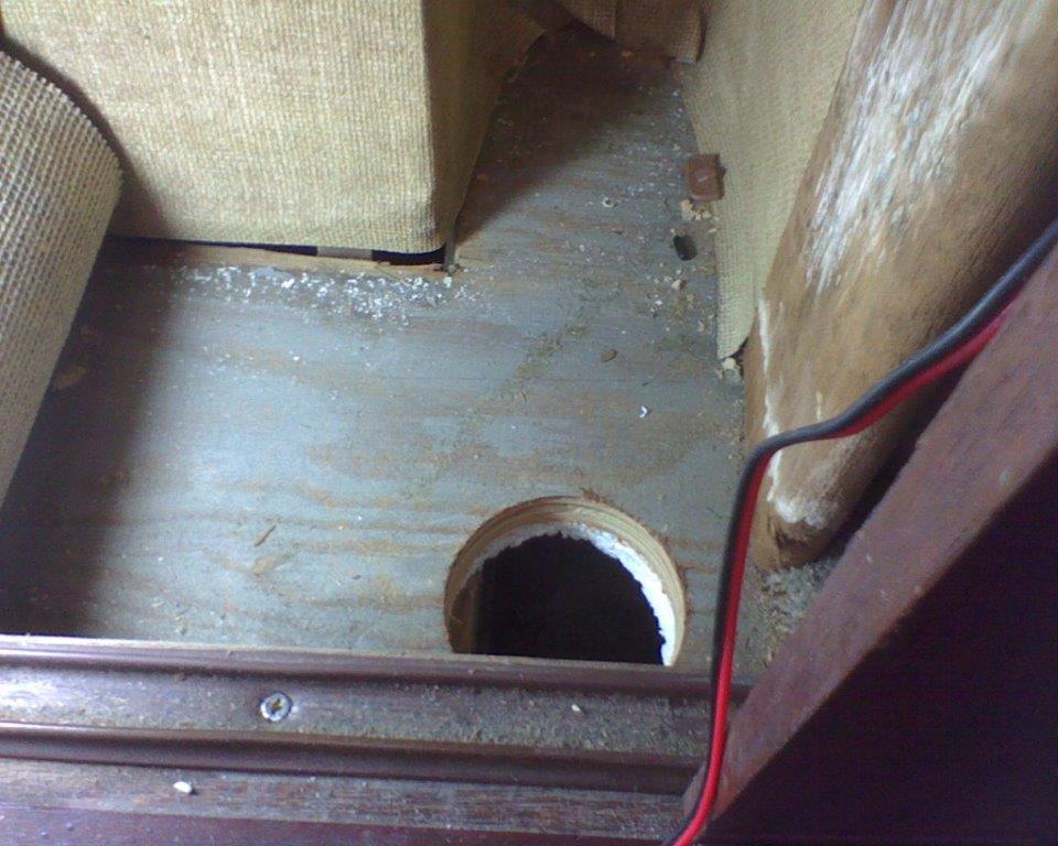

3" hole to install sender (offset a few inches)
sender 2s.jpg (104.83 KiB) Viewed 14698 times

Maybe those diesels are wider than my Mercruisers. My tanks are wedge shaped and I think the sender is offset to the inboard side. I have the extended range tanks below the cockpit, those gauges are next. Looks like you did a neat job, which is no surprise.

The tanks where replaced when repowered with the diesels . The OEM tanks where galvanized the replacement are aluminum . So the senders maybe in a different location then the OEM . Or perhaps the moved them inboard in the newer F36s , mine is older then yours .
