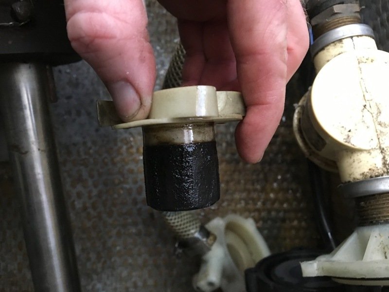

I know the pump is getting power (used one of these to confirm https://www.homedepot.ca/en/home/p.non- ... 64603.html, but obviously can't confirm voltage received unless I pull connectors apart) and I can hear a hum from the pump (but no vibrations) when it should be pumping. Pump is a 'Marine Development Corporation' (likely March) PMP500, 490 GPH at 3' head.
With the wet side cover off I could spin the impeller easily by hand. Could feel resistance followed by it jumping by itself because of the polarity of the magnets. Nothing physically jamming the impeller, and it was not fused to the shaft. It was a bit dirty / grainy around the magnet at the base of the impeller (with I am guessing metal filings or magnet filings...). Tried to 'wash' that at first before I realized what was going on, then used paper towels to wipe as much magnetic 'grit' off as possible. Not a perfect surface when I was done, but not sure how clean I should make it or scrape it without doing damage to the magnet.
Looked like this when I started - messy, but not a total mess:
