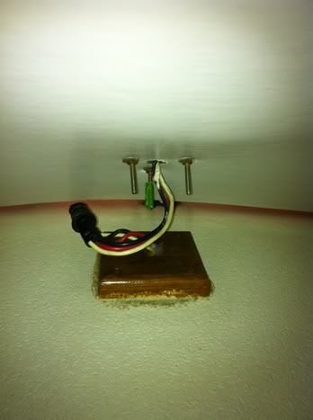

Posts: 1922
Here is the mast light wiring I was talking about - coming through inner liner of the bridge enclosure and feeding down through the hard top, through the wooden block.

here is what i did to water proof the mast light from the outside. i undid the bolts and while phil held the entire mast light, i used closed cell weather stripping around the exterior square of the mast. once the assembly was back in place, i reattached the bolts and it sealed the exterior. i then was able to remove the light assemby from the top and put a small rubber washer/gasket around the bottom of the light. that entire unit was sealed from the outside. in order to minimize any leaks from the bimini, i then used a plastic tarp over the entire bridge area and clamped it down just in case the bimini leaked. do not forget to use the capt tolley crack cure around the upper helm seat post blocks and concentrate on the screws from the top. you might want to use the crack cure around the stanchions and screws up there too... hey, it's a way to atleast minimize what could be any point of water entry. just a thought.
