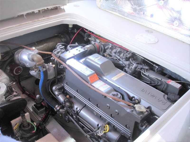

by Lt1240z
One of my motors
Just figured out picture posting :mrgreen:
