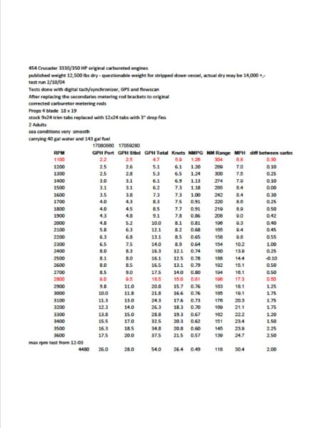

The EXPRESS has longer shafts and TWO struts per side
Midcabin has shorter shafts and ONE strut per side
Regardless of what's in there now you can make a choice:
smaller props spinning faster
or
bigger props spinning slower...
Attached below is the flo scan results of my 4 blade props with the gas engines before the diesel refit
Really not too shabby when one considers the actual VOLUME of this vessel.......
