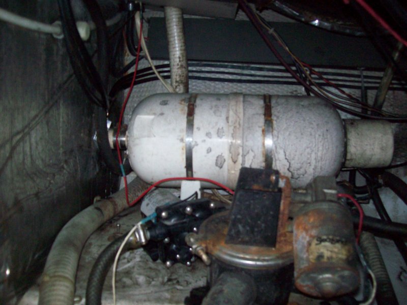

So Fighter, What Vacuflush model is that in the photo anyway??? I don't recognize it. It does indeed remind me of what we always called the "Air Canada Heads" that I had when I first bought my former 36 foot TriCabin. Maybe P Dogg had one as well.
Re: Vacu-flush system replacement??
Posted: Sun Nov 25, 2018 10:18 am
by P-Dogg
The cylindrical one is the old style. My new heads are served by rectangular tanks maybe 8x8x18, with the pump integrated into the top. Tank is under vacuum (i added vacuum gauges because none were provided by the factory, and thats what engineers do). When head is flushed, the goods get pushed into the tank by the column of air between toilet seal and outer space. Vacuum switch senses change in pressure in the tank, and the pump pumps the goods from the vacuum tank to the holding tank, which i placed immediately below vacuum tank. It is not much of a vacuum, only 10" of Hg, so the "vacuum" tank is 2/3rds full of air when ready for action.

One more opinion needed. Looking at the pictures of the toilet installation. I am guessing the pipe leading into the end of the Vacu Tank from the forward bulkhead is the flush pipe from the toilet. It appears to be an 1 and 1/2 inch pipe. Is it fair to assume it is 1 and 1/2 diameter up into the bowl of the toilet? If I can get the water out might be able to check it, but ??????
If it is 1 and 1/2 inch than could it be diverted and drain directly into the holding tank which is lower. Since lifting the lever up on the toilet brings in water and the slide valve for dumping is about 3 inches, why couldn't the existing toilet work like the Jabsco Twist and lock manual 29090 toilet?? Of course this is dependent upon the outlet being 1 and 1/2 inch diameter vice the 1 inch mentioned earlier in this post.

You would still need some kind of pump . I would not use gravity feed . Even if it did work you would smell the tank every time you used it . I relly don't know how well any pump but the vacuum pup would work on it
